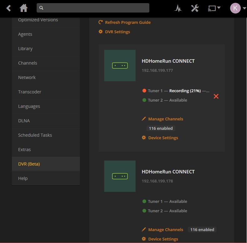

Thanks for the suggestion. You might be right but it just looks like Plex is just losing tuners. My environment has been quiet for hours and I have just kicked off a recording. The log says I have 2 tuners and it is now using one of them. But Plex Settings reports 4 tuners and one of them is in use! So it seems to be getting progressively worse.
I think I will reboot the host and see if that gets them back!

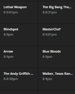

Have you looked at the shows that are going to be recorded to see what times it is going to record for? I have noticed several shows that are scheduled for one minute over the one hour time slot. For example next week I see that Lethal Weapon, Big Bang Theory, and Masterchef all are recording 8:00 - 8:31 or 8:00 - 9:01. This could cause a problem if I did not have enough tuners.

I’m currently recording one show using an HDHomeRun Connect with 2 tuners (OTA.) I observe one tuner LED illuminated on the HDHR device itself, and by viewing the summary page I see Tuner 0 Channel 671.000 MHz / Tuner 1 Channel none. On the DVR page of plex, it states 2 tuners—2 recording now.
