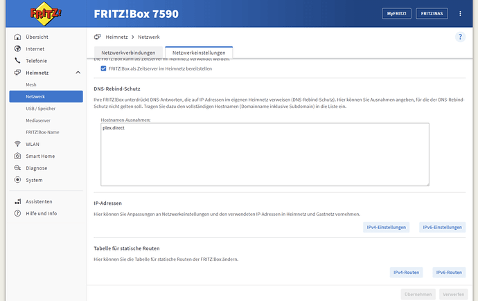

I think the main error is this:
Oct 18, 2023 17:38:58.578 [14168] ERROR - [MPVEngine/mpv] ffmpeg: tcp: Failed to resolve hostname 127-0-0-1.0ba89a8540a84d2d98d1cfb098bcb7ca.plex.direct: The name does not resolve for the supplied parameters
Oct 18, 2023 17:38:58.578 [14168] ERROR - [MPVEngine/mpv] stream: Failed to open
Potentially a DNS rebind issue: Dolby TrueHD passthrough - modified mpv build - #36 by gbooker02
Thank you! I added “plex.direct” to my DNS rebind protection exceptions of my FRITZBox! and now it works!
