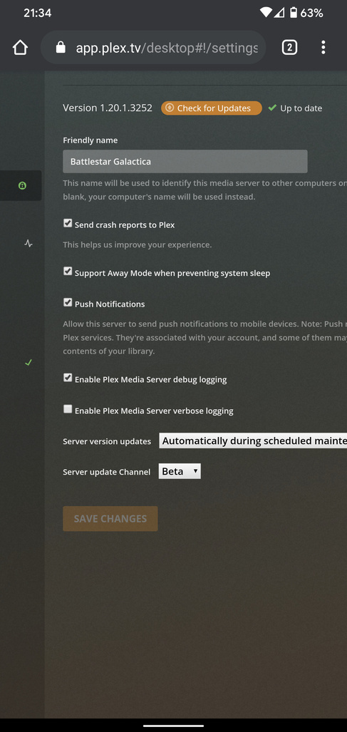

is it enabled on your server?
sure is :grin:
