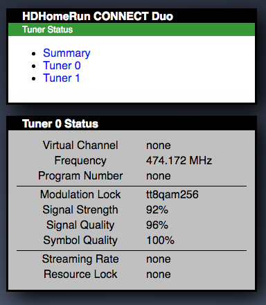

1x 2-way splitter. The HDHomeRun Config shows very good signal stats:

do you have dBmv values, similar to:
It’s not a cable box, it’s an over the air antenna:

I just removed the splitter and did another recording test, but the issue remains.
Interesting. Thanks for investigating. I will look into that, would have thought that HDHomeRun reporting 100% Signal Quality and 100% Symbol Quality would have been enough (getting that on BBC1 which still has the same Plex recording issues).
Also curious why Plex is susceptible to freezing on supposed missing frame data, when other apps like VLC, Quicktime etc seem to be able to deal with it fine.
I’ll look into my signal strength and report back.
