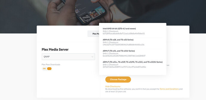

I would say it’s a checksum error, the download page (plex.tv) does not display the checksum properly when clicked. As I said, this was just a heads up, I will wait for the next update and try again.
All the Checksums are listed.
The “button” is the Yellow Text right near the selector
Adding to @ChuckPa here…
QTS use qpkg to install apps, and that again verifies that the qpkg file is valid, and otherwise will abort
As such, I simply suspect a bad download, so maybe try downloading again?
