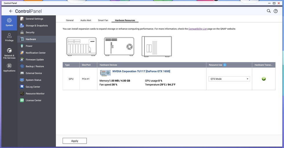

Which Nvidia card is in use here?
Turned on the Debug Logging per your request. Attached is the latest server log attempting to play a movie that stutters, then switching it to “Convert Automatically.”
The card is a Nvidia GTX 1650. According to QTS, the card is in “QTS Mode” and Hardware Transcoding is Green Checked. I have tried both the latest kernel and driver as well as the older one support recommended from their database search. Neither work.
