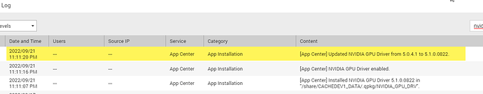

QNAP have shipped a new Nvidia GPU driver to their app store and my QNAP set to auto update installed it yesterday.

I have uninstalled and 5.1.0.0822, rebooted and attempted to try 5.0.4.1. Even after a second reboot the kerneldriver in app was still showing the new version?)
This didn’t help and have removed and reapplied the latest driver pckg (rebooting after each change)

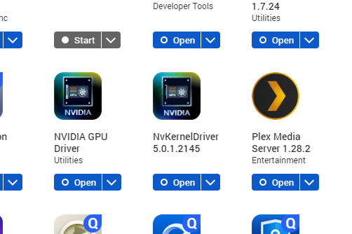

  3. QTS version 5.0.1.2145 (not QuTS)
  4. Version of NVIDIA_GPU_DRV
  5. What you see in the Control Panel (attached)

NVKernelDriver 5.0.1.2145
