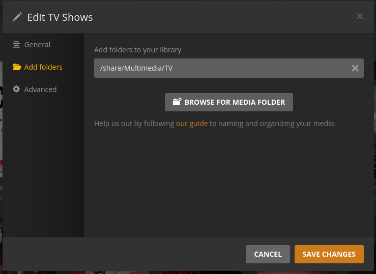

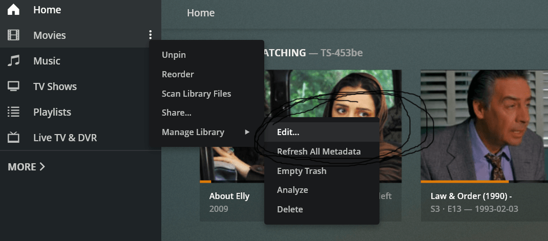

Does the library section also point to /Media or /share/Media ?
I hate to be the numbskull here, but where would I look for that? If I click on the “wrench and screwdriver” icon in the upper right corner of a page, I get a page that has two “library-like” choices: Settings/Library and Manage/Libraries. Neither of these choices offers a box to indicate where they might be in the file tree, and neither mentions either /Media or /share/Media. I am REALLY confused…
The /Manage/Libraries page does actually reference a Library called “TV Shows” as my only listed library and it (the library) is empty.

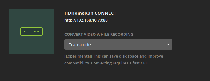

Is it possible you enable the option to transcode while recording by accident?

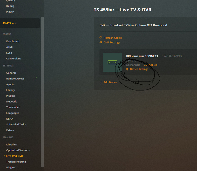

On the “Live TV & DVR” settings page, if you click “Device Settings” for your HDHomerun (or whatever it works with now) you’ll see this setting:
If that’s on, it’ll try to transcode your recording on the fly, so it would need a place to temporarily store the file while it transcodes.

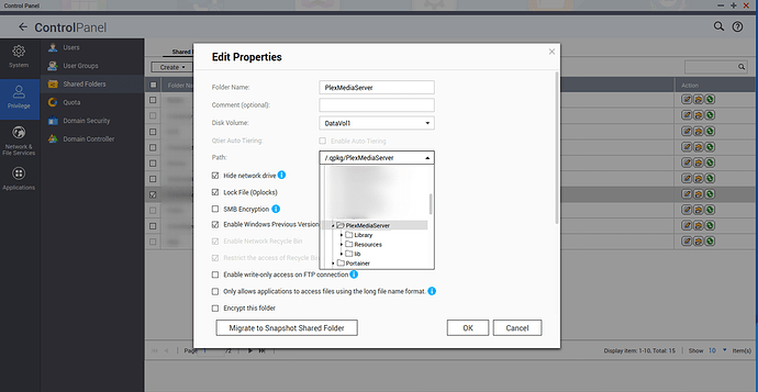

QNAP/QTS can be a bit weird with apps like Plex if there’s no “write” permission to do its thing.

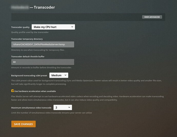

I don’t know if it’s the most straightforward/“right” solution, but I ended up creating a share and pointing it to the Plex directory:
Once that’s done, you can open the directory in File Station (bonus, you now have easy access to the Plex logs directory too). I then created a folder named “temp” in the PlexMediaServer directory:
Next, on the transcoder page, I used that as the transcoder temp directory:
Then you can tell it’s working when you see the directory fill up with media files:

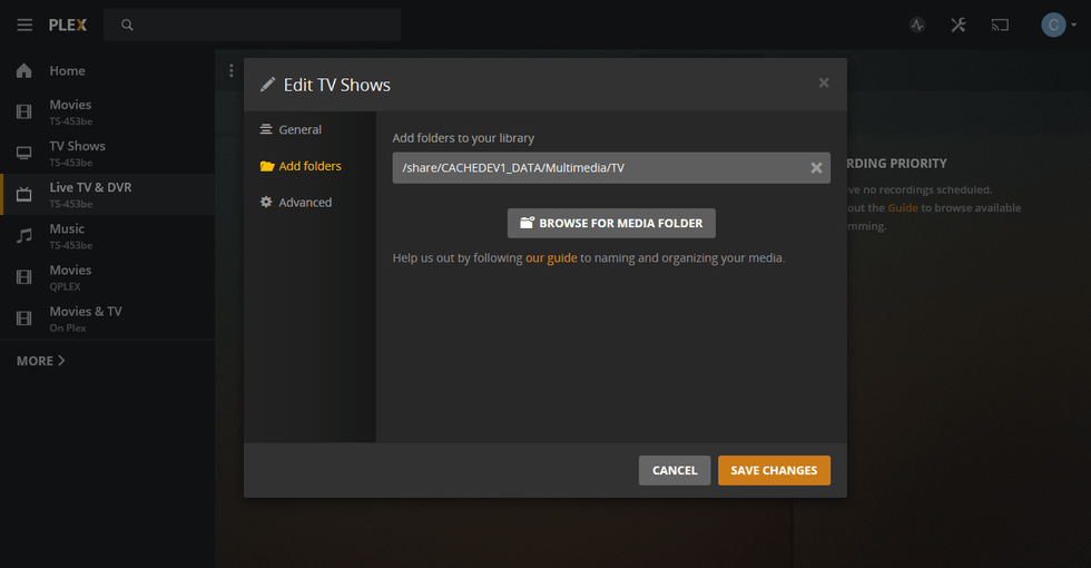

Thank you for posting. The root problem is obvious.
You’re using the Multimedia share. This isn’t a real / physical share. It’s 100% artificial.
In the QNAP FAQ, we expressly caution to not fall into this.
The solution here is simple but will take a few steps. It involves the same steps as if moving media to a new location. In this case, we’re not moving it but changing how it’s addressed.
As example, Assume:
  1. TV is actually spread across 3 shares. /share/tv, /share/tv2, and /share/tv3.
  2. /share/Multimedia was used because it does a nice job of consolidating.
  3. However, it consolidates for READ, not for WRITE. There is no destination for when writing.
  4. When media is added to the share, only a link is created. Nothing is actually moved. This is where the confusion starts.
We resolve this by:
  1. Add the real sources to the list and keep the existing Multimedia reference. (EDIT the folder list for the library section).
  2. As the sources are added, PMS will scan
  3. Your media will show the indicator 2, which means it found 2 copies (or another path)
  4. When all media has been so marked as duplicate (wait for the scans to finish)
  5. Remove Multimedia from the list (EDIT the folder list again)
  6. It will scan one final time.
  7. Observe the 2 being removed
  8. When complete: Scan Files (one last time), Empty Trash, and Clean Bundles.
  9. The addressing has now been changed.
From this point forward, your DVR will be able to access the real physical shares and not the 64 MB root partition of the QNAP nas.

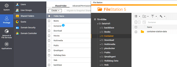

Here’s a screenshot of my FileStation, next to the “Shared Folders” area of my NAS (you can find either one by typing those names into the search box on your NAS):
See the folders that are “greyed” out under “Shared Folder”? Those are shares that the Qnap NAS itself manages. Because I’ve disabled the Multimedia Center, my Multimedia folder isn’t greyed out, kind of like if you disable “home directories” you can then even delete the directories.
So when someone says to create a “share”, they’re basically saying to create a “top level” folder in FileStation (in my example, Books, plexdocker, etc. are all top level/parent folders).

For question #1, why is it trying to transcode, I recommend checking your DVR settings.
From the server settings area, click “Live TV & DVR”. Then click “Device Settings”:
When you do that, do you see an option named “Transcode”?
If so, then that’s why your DVR shows are being “transcoded” on the fly. Because you’ve enabled that setting. So what Plex does is convert your recordings to h.264 as it’s recording, which saves space but uses more CPU.
If you don’t have any interest in that, you can just choose “off”:

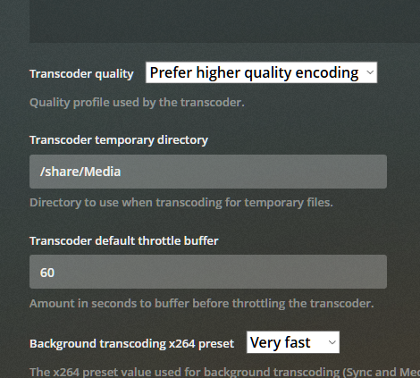

In regard to what you should enter in this field:
The answer is a directory that you have permission to “write” to. There are some system directories that you can’t save files to on the NAS. Think of it like how there are some Windows directories you can’t delete or save items to (or if you manage to, it causes issues).
I believe Trexx was suggesting you type “/share/Media” into that blank field.
Like this:
Or, you could create a folder named “Temp” in your Media folder, and use “/share/Media/Temp” instead.

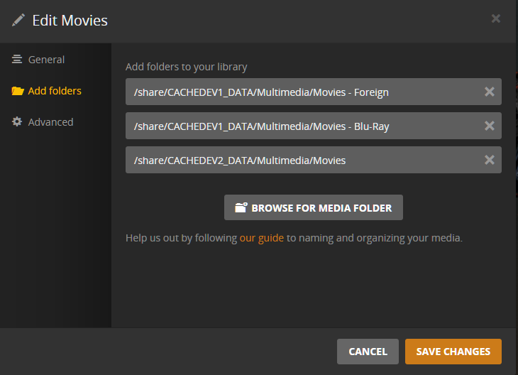

I think he was asking you to view the settings for your library, which you can do by “editing” a library.
Then, under “Add folders” you can see what the “path” is to the folders you’re using. Does it say “/Media”? Or does it say “/share/Media”?
Here’s mine, for example (yours doesn’t have to look like this, just including it as a reference to what those settings look like:
The way Qnap treats shares/directories sometimes they can be something like:
/share/CACHEDEV1_DATA/Multimedia/Movies - Blu-Ray
But if you use:
/share/Multimedia/Movies - Blu-Ray
or
Those could all just be different ways to point to the same directory, depending how things are setup.

Type:
/share/Media
Into the “Transcoder temporary directory field”.
