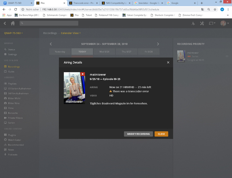

Hello,
since the last plex update, there is an “transcode error” while recording
Plex Media Server Logs_2018-09-24_06-31-15.zip (4.4 MB)
The recordings starts at 20:05
Any Ideas? What can i do?
Thx very much for help.
greets Michael

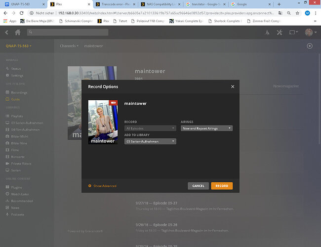

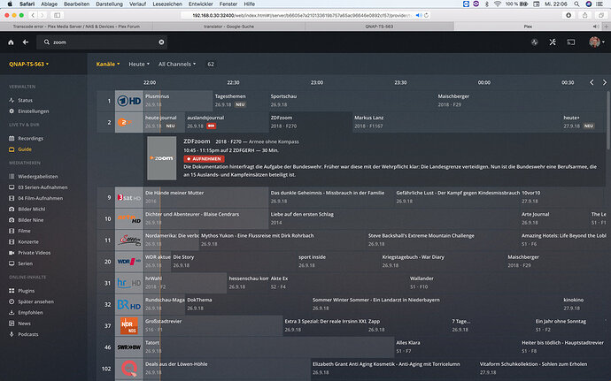

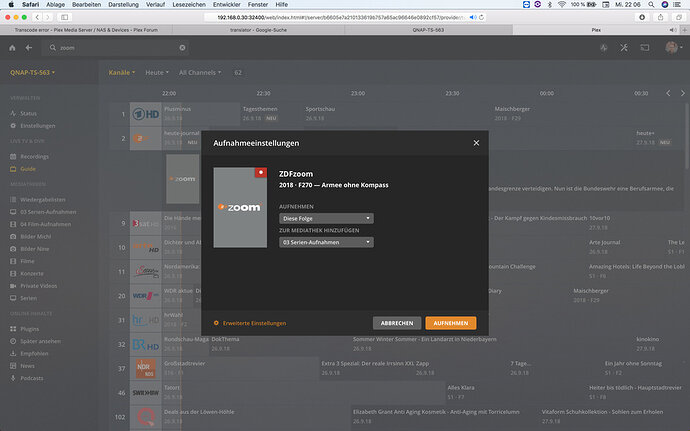

Making a new record

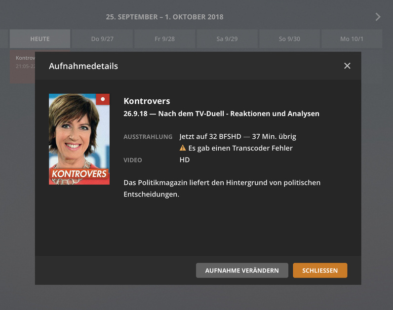

Getting this error
That does not solve the problem.

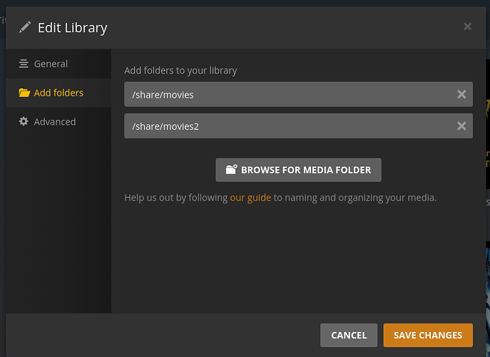

This is my Animated Library . Notice the path. It points directly to the real volume. /share/CACHEDEV2_DATA/animated and /share/animated are the same location. (linux trick).

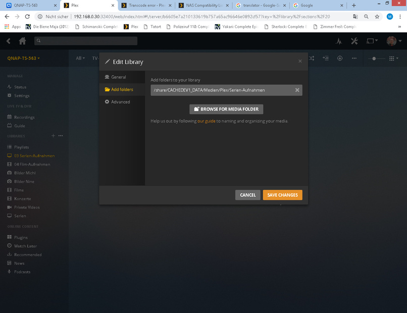

Now i have:

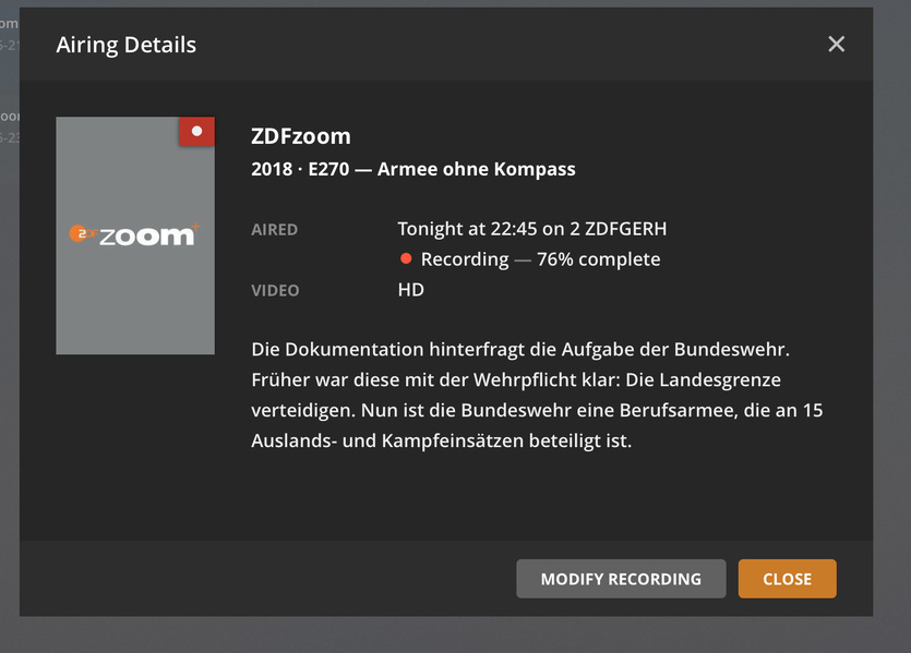

Intersting: Recording a single movie, there ist no problem
Recording a show/serie the recording is failed
