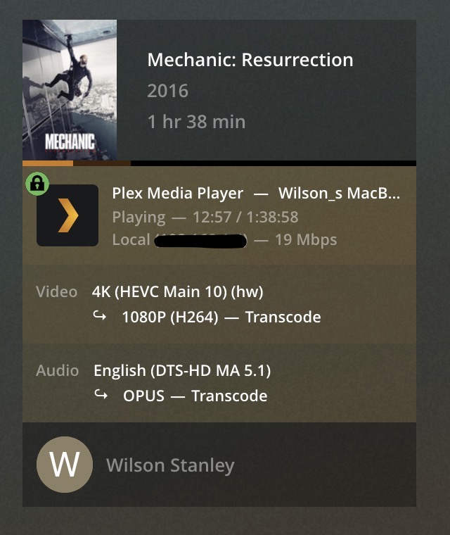

I have a TS-673 that I have installed a MSI GTX 1650 GPU
I have been able to get the GPU to decode but not encode, it seems to be using the CPU.
The CPU runs at nearly 100% but the GPU is only using 20-30%
It would be good to get some load off the CPU.
Has anyone had a similar issue?
Is it just not possible at this stage?
Screen Shot 2020-03-12 at 12.58.23 pm

Checked that, I used to get (hw) on decode and encode on my old TS-653B which had integrated intel GPU.
I have just migrated to TS-673 with the same HDD’s so no Plex settings have changed.

Sorry for the slow reply, only just got around to testing.
I have 4.4.21270 and Plex 1.19.1.2701. It is encoding and decoding the video with HW but not the audio so there is still some load on the CPU but no where near as much as before.
