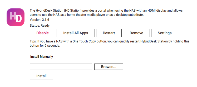

  1. Install (or verify that it’s already installed) HD Station. I disable ALL HD Station apps. Definitely disable the Plex client that is offered within HD Station.
  2. Download the Father Mande custom Plex Client at father-mande.ovh/Q/qpkg/openpht_1.7.1.zip
  3. Extract the Plex Client zip to your desktop. The file should be a QPKG file.
  4. Navigate to the desktop of your NAS and click on HD Station. Once there, you should see a area that says “Install Manually”. Click the “BROWSE” button to the right of that box and locate the QPKG file from step 4 above. Click Install. See pic below.
