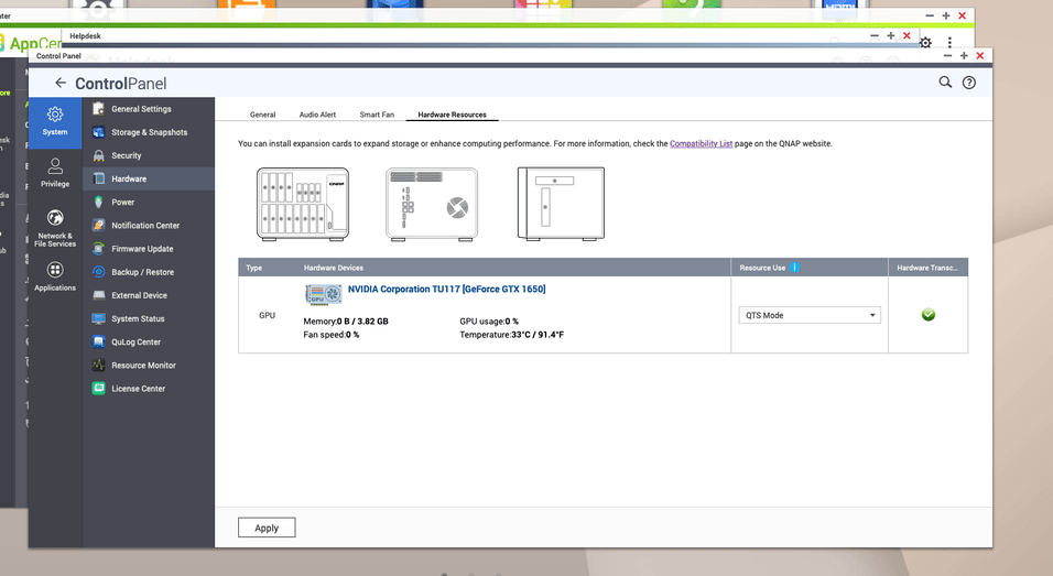

I believe there has been posts on this before last month, but thread closed. The problem seem to have been resolved for others but persistent for me. I purchased the TVS-H1688x a month ago and put in the GPU yesterday. The card was recognised but GPU and fan speed on 0%. Set to QTS.
Ticket with QNAP opened.
Are others still having this issue?
Thank you in advance.

Yeah, no good. I even tried what the QNAP rep suggested which was try transcoding using Video Station app. CPU and Fan still reads 0%. Only temp reads a value.
Even if it displays erroneous values, did you check to see if it is transcoding in plex?
P.S It was reported that h1688x had issues with GPUs but that was reported as solved in latest QuTS releases
How would I check this if it doesnât display correct values?
Try playing a movie that you know needs transcoding, then check the dashboard

Thanks. I was using the 5.0.3 and was concerned when I wasnât seeing any stats on the card like the others thinking it wasnât recognised. I am back to my original posts configuration on 5.0.3.
I tried some transcoding and on my second simultaneous transcode I see (HW) in the status. Does this mean Plex is using GPU to transcode even though QNAP reads itâs asleep?
But I guess it could just be using the Xeon CPU for (HW) transcoding?

âAfter the internal check, our Multimedia support team reply the current design is that models with internal graphics will preferentially use the internal graphics GPU during video transcoding. If there is a second video transcoding requirement, an external graphics GPU will be used. That is why when only doing one video file transcoding, the GPU usage & FAN speed still keep 0%.â
I can confirm that using QNAP native software (video station) on NVidia drv 4.0.2, I do see utilization of the graphics card with 2 transcode. However, I dont see this with Plex even with 3 transcodes. This is their reply
âSince the Plex is 3rd party APP & come from Plex vendor, therefore, we could not control video file transcoding behavior in Plex media server APP.â
So I am guessing in order to use the graphics card, like Chuck said, the preference xml has to be altered?
