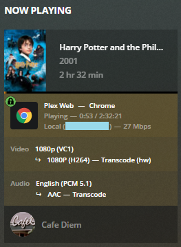

Ditto, it would be great to just get this working for you. On a lark, I just did a transcode of VC1, which no hardware can accelerate in Plex (as far as I know!). Take a look.
harry-potter
Plex can absolutely accelerate encodes even if decode acceleration is unavailable. If you’re logged into your machine, have Plex installed, are logged into your Plex Pass account, and you’re still getting no acceleration, that’s really strange. What CPU are you using? Do you have any other video card in the computer?

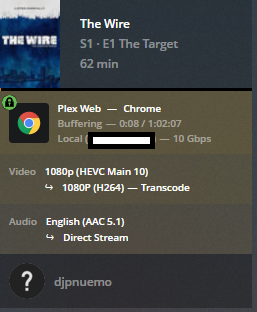

Okay, so I’m testing a HEVC → H264 transcode with debug/verbose logging enabled. Here is a screenshot and parts of the log that were interesting.
2019-06-17%2009_26_49-Plex
Jun 17, 2019 09:26:34.270 [6440] DEBUG - Codecs: testing h264_qsv (encoder)
Jun 17, 2019 09:26:34.270 [6440] DEBUG - Codecs: hardware transcoding: testing API qsv
Jun 17, 2019 09:26:35.243 [6440] INFO - [FFMPEG] - Initialized an internal MFX session using hardware accelerated implementation
Jun 17, 2019 09:26:35.303 [6440] ERROR - [FFMPEG] - Selected ratecontrol mode is not supported by the QSV runtime. Choose a different mode.
Jun 17, 2019 09:26:35.306 [6440] WARN - avcodec_open2 returned -40 for encoder ‘h264_qsv’
Jun 17, 2019 09:26:35.715 [6440] INFO - [FFMPEG] - MFT name: ‘Intel® Quick Sync Video H.264 Encoder MFT’
Jun 17, 2019 09:26:35.715 [6440] ERROR - [FFMPEG] - could not set input type (c00d36e6)
Jun 17, 2019 09:26:35.809 [6440] WARN - avcodec_open2 returned -542398533 for encoder ‘h264_mf’
Jun 17, 2019 09:26:35.810 [6440] DEBUG - Codecs: hardware transcoding: testing API dxva2
Jun 17, 2019 09:26:37.830 [6932] DEBUG - TPU: hardware transcoding: zero-copy support not present
Jun 17, 2019 09:26:37.830 [6932] DEBUG - TPU: hardware transcoding: final decoder: dxva2, final encoder:
Of course there are references to h264_nvenc but obviously that fails due to not having any NVIDIA device.
