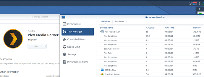

It happened again today (25.04) around 18:58. Few hours before the crash I noticed DSM was using CPU (indicator in the red, with the Plex task on top of sorted tasks). ~4 hours after the crash I went to start Plex back, but noticed the CPU was still being used, went to see what’s using it - and it was Plex, even though its package was stopped as of few hours. It’s not supposed to be that way, right?
