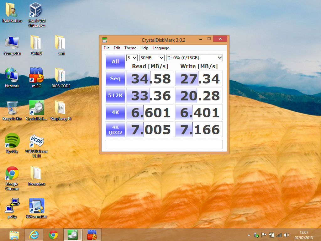

Look what turned up in the post this morning.
Sandisk Extreme 16GB USB 3.0,
That’s a test @ USB 2.0, it’s the fastest USB stick I have EVER seen.
Wow that looks even more responsive that it did for me!!!
Did you leave it open for a while to cache thumbnails? It looks like on deck loaded really fast.
