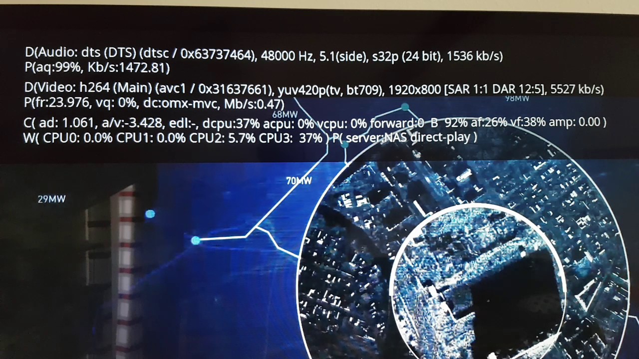

Hi everyone,
i have a problem with DTS-Movies on my Rasplex 1.8.0. RasPlex is installed on a Sandisk Ultra 16GB Micro-SD card. Even took another card for testing with same results.
My Plex Server Version is 1.7.2.3878 on Synology DS916+ (tested as well with Plex Server Version 1.7.2.3878 (Windows) installed on SSD’s on a DELL T20 with 32GB RAM)
RasPlex 1.8.0 runs on a Raspberry Pi 2 (tested on 2 identical Pi’s, same problem) connected via HDMI to a Denon AVR-X1200W (with a 5.1 Speaker-Setup) connected to a Sony KDL-55HX825 TV.
RasPlex:~ # tvservice -a
PCM supported: Max channels: 8, Max samplerate: 192kHz, Max samplesize 24 bits.
AC3 supported: Max channels: 6, Max samplerate: 48kHz, Max rate 640 kb/s.
DTS supported: Max channels: 6, Max samplerate: 96kHz, Max rate 1536 kb/s.
EAC3 supported: Max channels: 8, Max samplerate: 48kHz, Max rate 8 kb/s.
DTS_HD supported: Max channels: 8, Max samplerate: 192kHz, Max rate 8 kb/s.
MLP supported: Max channels: 8, Max samplerate: 192kHz, Max rate 8 kb/s.
My settings are:
Audio output device: HDMI
Number of channels: 5.1
Support 8 channel DTS-HD audio decoding: Unchecked
Enable passthrough: Checked
Dolby Digital (AC3) capable receiver: Checked
Dolby Digital Plus (E-AC3) capable receiver: Checked
DTS capable receiver: Checked
But no matter what settings i use, it doesnt help.
Every DTS-Movie runs for some seconds, then stops for a while… runs for some seconds… stops… runs… stops…
I don’t know the exact output from plex, but it seems 2 buffers (B and VF) are running low and it refills them… then starts playing again until buffer is empty again.
I made a movie of the output cause i cant describe it any better.
I know RasPlex was playing these movies w/o any Problem in an earlier release. Just dont ask me, what release it was.
What really makes me suffer is that if i use Kodi (OpenELEC or OSMC) with the AddOns “Plex” or “PlexKodiConnect” (on same Hardware and SD-Card), every DTS Movie plays fine w/o any stuttering or other problems. There are other - UI related - reasons why i would love to use RasPlex.
My Amazon Fire-TV Stick (on another TV) plays every Movie w/o problems, same with PS/3 with Plex Addon - no matter if DirectPlay or transcoded.
I would be glad about any advice :wink:
Nachtwind
Nachtwind
Your audio settings look correct to me. Maybe your network connection (speed) is not handling the bitrate?
Your Pi connected via WiFi or cable?
My Pi is connected via cable (GBit connection - tested and working fine on any device) and if i use Openelec with “PlexKodiConnect” or “Plex” addons, it works w/o any problems on same Pi. And it only happens at movies with DTS-Sound - but there all of them. Even if its only 480p DVD Quality
