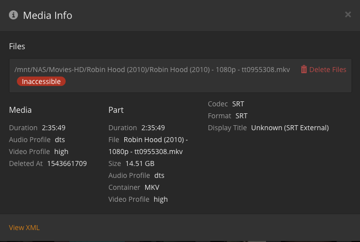

This an example of the error I’m seeing. There are about 10 movies in this library which show the problem, the rest is okay.

No, the NAS is always available and does not spin-down. Also, the 10 movies that are inaccessible or unavailable seem at random places (not the first or last 10).
I have accessed the NAS directly and played one of the movies directly from the NAS, without the use of Plex, without any problem. Even when scanning while playing the movie, Plex does not see them…
I have also tried to move the files to another location (non-Plex folder), scan + empty trash, move back to Plex Movie folder, scan again. It still does not recognise these 10 movies… It is really strange, because the files seem to be okay…
I have also tried to add one of those movies to another library (Movies 3D) but Plex does not see the file there either. Does not seem to be a problem with the library but with Plex or the movie file, it think…
I figured it out. I have set the folder permissions again, and checked the box “Apply to this folder, subfolders and files”. That did the trick, so it seemed permission-related :wink:
