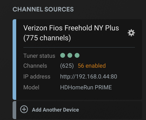

Server Version#: Version 1.41.3.9314
Tuner Make/Model: SiliconDust Home run Prime
Guide/Lineup name: Fios
Using XMLTV?: no
Channel number/Name: 580 MSGSN
My recording is inconsistent at best. Sometimes it’s difficult for Plex to even accept a recording (ie: I go through the scheduling, but after saving, it doesn’t even get scheduled), sometimes it gets scheduled, but doesn’t actually record.
The tuner works when I select a channel to watch in real time.
And after a few attempts, I was able to schedule the recording:
But it did not record. I’m not fluent enough in Plex troubleshooting to figure out what the issues are.
I see one oddity in the logs that says a device isn’t compatible, but everything has worked for years.

What is your network topology, and has anything changed (if it was working, but is now a problem?) Without a full set of logs I’m not seeing what the IP address is of your Plex server, and so can’t tell if your HDHR tuner is on the same subnet as your Plex server. Every ~20-25 seconds Plex is removing your tuner because it isn’t seen on the network:
Jan 19, 2025 07:09:13.651 [131215824792376] DEBUG - SSDP departed after not being seen for 22.410932 seconds: 192.168.0.44 (HDHomeRun DRI Tuner 1311D52B)
Jan 19, 2025 07:09:13.651 [131215824792376] DEBUG - SSDP departed after not being seen for 22.410970 seconds: 192.168.0.44 (HDHomeRun Prime Tuner 1311D52B-0)
Jan 19, 2025 07:09:13.651 [131215824792376] DEBUG - SSDP departed after not being seen for 22.410988 seconds: 192.168.0.44 (HDHomeRun Prime Tuner 1311D52B-1)
Jan 19, 2025 07:09:13.651 [131215824792376] DEBUG - SSDP departed after not being seen for 22.411003 seconds: 192.168.0.44 (HDHomeRun Prime Tuner 1311D52B-2)
but then it quickly retests for your HDHR tuner and makes it available again.
Jan 19, 2025 07:09:13.661 [131215789140792] DEBUG - DVR:Device: Testing grabber HDHomerun device device://tv.plex.grabbers.hdhomerun/1311D52B at http://192.168.0.44:80
Jan 19, 2025 07:09:13.661 [131215789140792] DEBUG - DVR:Device: Device device://tv.plex.grabbers.hdhomerun/1311D52B was already known, refreshing database info
And it does this several hundred times in the ~4 hours that your log snippet covers. This looks like a network problem, not specifically a Plex problem.
Nothing changed that I intentionally changed, but I could imagine I did something while messing with the homelab that I forgot I did or how it would impact my server. Maybe a firmware update to the turner that I never tested afterwards?
Fios ONT > FIrewalla Gold SE > a couple of TP-Link managed switches. Everything on the same subnet (192.168.0.xx). Plex Server is 192.168.0.134.
As a ‘network’ problem, any suggestions on what to look at? Other than the Plex DVR not recording, I’m not having any issues that are exposing themselves in real-world performance. No complaints from the kids on tablets, phones, Roku, or Plex.
