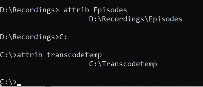

Be worthwhile checking folder permissions for the various folders you use with Plex, for example the one above and whatever folder you use to store your TV recordings in.
Thanks e10kstarfire, but I did this and can confirm that both the Episodes folder (which is on a 4Tb drive labelled D: and the transcodetemp directory (on C:) havent got read only set on them.
I can watch the files being written into the transcode temp folder. They are all sequentially numbered, starting at 00001.ts and going up by 1.
