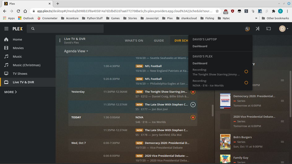

The only error I see that might be associated with the third show is
Oct 06 03:08:18 shankscloud locast2plex[20984]: [hls,applehttp @ 0x55fba9dc6900] Failed to reload playlist 0
But the system was already in a possibly unstable state due to the prior errors. And as I said up thread, the recording completed properly once I killed its hung Plex Transcoder process. So I’m going to ignore that error for now.

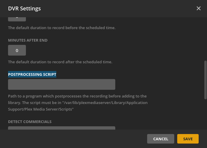

Moving forward, I’m turning off the “Convert Video While Recording” feature (see below). I want to see if that improves things. Previously it was set to “Transcode.” Plex says Transcode can improve compatibility (With what? How? and Why? Plex help and documentation truly sucks), but they also say it’s a Beta feature. Maybe turning it off will improve stability.
