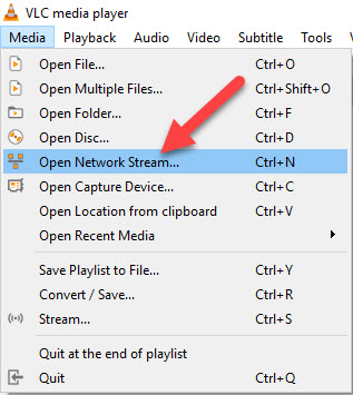

Leave the browser window open and Open VLC. From the Media menu select Open Network Stream:
