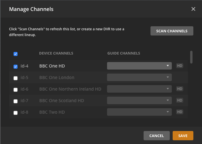

(I tried to change the mappings in Manage Channels)
So I set BBC 1 HD:
Click Save.
Then go back into Manage Channels and the setting is gone:
And just tried with a different guide (Sky Q)
Same thing happens when editing channels.

Ahh, think I found my issue.
I still use PMP for most of my admin tasks, but it seems the admin for Live TV and DVR does not work properly in that. (It has all the same options as the web app, they just don’t work properly!)
Using the web app instead seems to have solved the issue.
