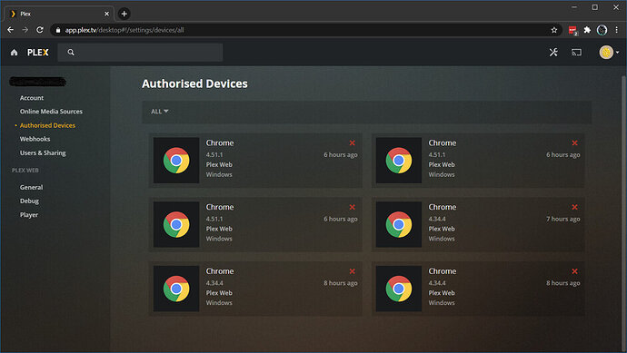

Thanks @ChuckPa for the quick response.
I’ve followed your steps and removed all authorised devices (see screenshot).
There was no server instance in the bar on the left (as you can see) so I skipped that part too.
I then signed out of plex and closed the tab.
After opening a new window with the plex web page it asked me to sign in again and I get the online services on the homepage but no mention of my server in the navigation bar on the left and if I go to settings no mention of any servers in the list on the left - any ideas?
