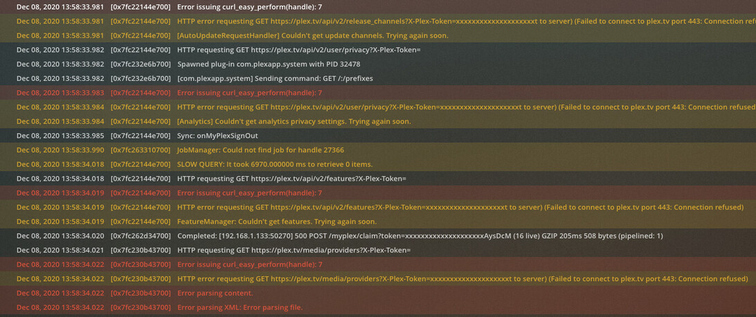

Having Trouble Claiming a server that had previously been working. After Updating QNAP firmware and Server versions I Can not get the server to Claim. I tried the claimpms.sh shell script and got an internal server error. I Have tried Changing the DNS to 8.8.8.8 and 8.8.4.4, which didn’t change anything. I have noticed the same server is currently not populating Artwork for content locally on the NAS but the plex streaming content does have artwork. QNAPplex Logfile 20201208.txt (22.8 KB)
Sorry, but the logfile you attached, is from the webclient, and the screendumps makes it hard to read and search
What I need here, is for you to provide the output from the claimit.sh script in a screen dump, and did manage to spot on you screen dumbs, that you are faces with curl error 7, meaning
CURLE_COULDNT_CONNECT (7)
Failed to connect() to host or proxy.
So start by checking your QNAP DNS Settings, as well as the default gateway first, before providing what I asked for

Tried this with Both DHCP IP settings and Static. For DNS I used 8.8.8.8 and 8.8.4.4 using Google DNS it took much longer to give the fatal error message.
So, since you did manage to get the user token from plex.tv, I would assume that your gateway as well as DNS is okay
However, the 500 error is an internal PMS error code, so please look here on item 1 and 2:
