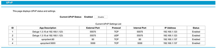

Sure, this is what’s configured… I’ve been trying various things, disabling upnp, fixing the port etc etc so the logs might show some odd stuff. But this is how its usually configured, upnp with port chosen by plex. It’s worked for years, occasionally it shows as ā€˜not available’ but either a router reboot or clearing the upnp ports on the router and a reboot usually has it sorted.
