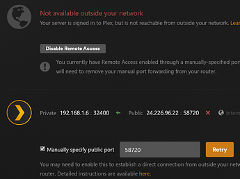

OK… a major update here. As mentioned above I went on two weeks holidays where I could not remote access at all. Tried it at least a half dozen times; quite frustrating. When I returned of course, Plex had a red circle on Remote Access and showed:
Not available outside your network
Your server is signed in to Plex, but is not reachable from outside your network.
Today, I had two of my buddies test it and it works; even though Plex continues to report the above. So what gives?

Still waiting for a response from my ISP but decided I do some more tests and went to my ASIS router. I just noticed that my WAN address is 192.168.0.2. Wow… a class C private address.
The router is a Sagemcom f@st3896; its pretty new on the market and I cannot find a manual for it anywhere. I’ve put in another call with Cogeco support and waiting for a call back…
OK… so this new modem has a full router in it. I told the ISP to disable the Wi-Fi when I ordered it; since I have an ASUS mesh here… obviously they did not. So once I realized what was going on, I asked them to put it in bridge mode and now everything works. Port sniffers work and more importantly Remote access has been solid green and “Fully accessible outside your network.”
