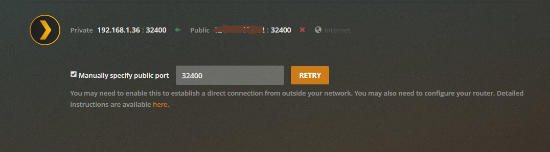

Hi all, hopefully someone can help me find the remote server. I’ve read several posts and the troubleshooting already. Thank you very much in advance
  • Originally, i had double NAT, which was confirmed by seeing different IPs in what’smyip vs the plex web app. Also, when i did a traceroute, there were 2 internal IPs on the first two jumps
  • I then switched my 2nd router to bridge mode. So my PC/plex server is now on the 1st router’s network. Seems like double NAT no longer…
  • I tried both automatic and manual setting. when i did manual, i changed public port to 32400
  • in my router port forward settings, i direct port 32400 to my plex/pc
  • I restarted plex server, pc, and routers
Am i missing something here?

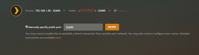

after restaring evrerything, my public IP in plex is now different from my canyouseemy IP.
in fact, it changes every time i click refresh
it seems like there is some sort of double routing issue, but any idea how to fix please?

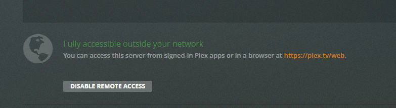

my isp provided me with a IPV4 address free of charge.
plex no longer shows an error
