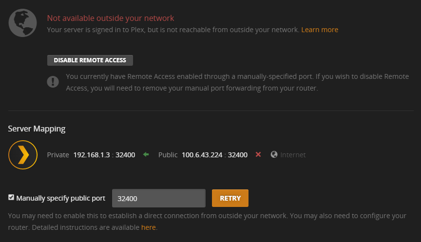

Never had an issue with Remote Access before, then added an IPFire Firewall box in front of our home network.
Followed all st https://support.plex.tv/hc/en-us/articles/200931138-Troubleshooting-Remote-Access
Specifically:
Here’s what my remote access settings page looks like right now:
Having the same issue. I can connect via a browser from the outside to https://(myplexip):32400/web and it works fine. Tried different ports, tried installing on a different computer, uninstall and reinstall. Do we have access to an older version (wish I had kept one) to test?
You need to disable remote access, set up your router with port forwarding 32400 and enable remore access (and tickin that wee box). Had same issue and now works fine.
Hello Sharbb, I have tried that quite a few times. Even changing the port. It works with a browser test from outside my network (https://MYIP:32400/web), so I know the port forwarding is correct, and it worked before the last update. I think there may be something in their phone home check that now fails their connection test. Not sure what their criteria is for a connection test. Very strange. I also turned off Windows Defender as a test, since it has given me trouble in the past, where I would have to add an exception. My first test is to disable, then add an exception if it works. I appreciate the assistance!
Have you checked to make sure you’re not in a double-NAT situation?
Yes sir. Went through all of the posted troubleshooting steps. I have a dedicated PC for my firewall (IPFire). One NIC is attached directly to the modem, and the other NIC is attached to a GB switch for internal traffic. No other router/firewall in the mix. Wireless has all firewall/routing functions off. Windows firewall is off. The kicker on my troubleshooting is that port 32400 does work, it just doesn’t think it does! :slight_smile:
