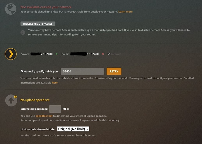

Here is what I’m seeing:
And this is the error I’m getting:
It’s saying that it can’t connect to my public ip address. I called my internet provider and they said that it’s working and accessible. This leads me to believe that it’s not my internet but rather something with Plex itself.

Please provide more info here about your router, and how you configured port forwarding
It’s an Xfinity Gigabit modem. Below is the port forwarding setup. The correct private IP address is in the ip4 box.
Is the 32400 port also manually configured in PMS?
Since managed to connect for about 5 sec. towards http://<YOUR_PUBLIC_IP>:32400/identity and 5 sec later, I could not!
I entered it in the “manually specify public port” box as shown in the pic I uploaded. Do I need to enter it somewhere else also?
Nope, but above then IMHO indicates a bad router
The router is working exactly as it should, the tech checked it today. There is no problem with my internet at all except for where Plex is concerned. Every single thing works with my internet except for Plex.
Not sure I understood your previous post about connecting to my public IP.
And since you all the time can access it locally, I only see one thing between your PMS and the Internet, and that’s your router, sorry…
