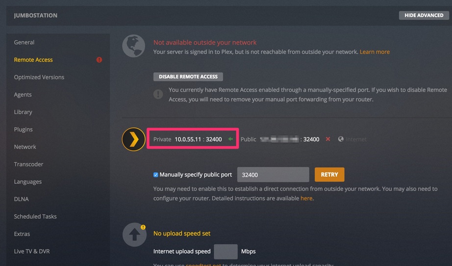

    If I choose the settings > server > network >Network interface to listen on to All or just eth1 it will only use eth1.
    Under server / remote access > enable remote access, the private IP is always eth1. If I disconnect eth1 and reboot, it still shows eth1.

  4. Private IP is showing my Camera network ‘eth1’ on my Synology
  5. Select Network
  6. Network interface to listen on eth0 (10.0.0.10)
  7. Select SAVE CHANGES
  8. Plex is restarted via Packages Stop/Start
  9. Setting Server -> Remote Access (red !)
  10. Try to enable remote access and get the message not available outside you network.

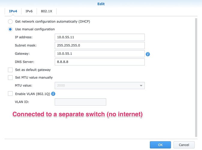

Thanks. I found your problem.
IP: 10.0.55.11
Gateway: 10.0.55.1 – which is NOT an internet gateway. This field should be empty.
As separate resolution method:
  1. eth0 is the first adapter Plex always finds. Make it the internet gateway connection
  2. eth1 can be LAN-only without harm
(swap them)
In either case, if the adapter does not have have an ethernet connection, it does not get a “Gateway” address value
Hi Chuck,
The gateway on the 10.0.55.1 eth1 has been removed.
  • I still have the same problem, The Synology was also restarted.
    Earlier on in the thread, I’ve mentioned that swapping the adapters makes no difference.
    I’ve also disconnected the eth1 (port 2) on the Synology, rebooted and shows ‘Disconnected’, still the same problem.
