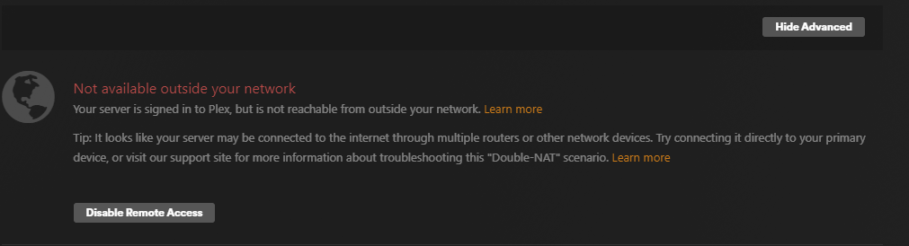

I’ve had my server working for 2+ years fine, I have had some issues before with remote access when the server changes its IP but always fixed by changing the port forwarding data to reflect the new IP. I have the exact same setup I had at my last place just a different ISP now and now it is not working. I’ve tried to reset the forwarding ports, changing the ports, opening new ports within the range of 32400-50000, I’ve tried turning uPnP and port forwarding off and on again, dual wan is off. Nothing is working, the server is accessible remotely just not higher than 720p/1080p, can’t get direct connection to work outside of network. The server is still the same IP as before.

With all likelihood your new ISP uses CG-NAT, Request to opt out which can be free in most cases or pay for a Static IP address which normally incurs a monthly fee.
