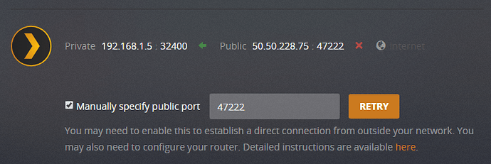

Did that, after that this is still what i get:

Why is your network location public? On your internal LAN you should set that to private. Public will cause Windows to shut down sharing. Set it to private, and then verify you have the proper Windows firewall entries for Plex Server for incoming connections. You should have a few entries in there, and make sure that they are enabled for private.
You are most definitely in a double NAT situation. Your WAN port is a private IP address (192.168.xx.xx is not a public IP address). Please list all of your network hardware, like this:

Yes, those entries are correct. You have to solve your double NAT problem before you can have remote access.
