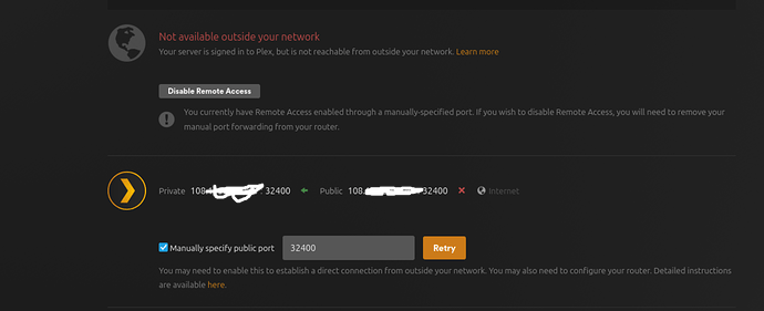

I use AT&T Fiber and it has worked flawless up until about 3 days ago. I run on a dedicated static WAN ip address so I have a fully open address. I no longer can access my server outside my network. Remote functions do not work. I’ve tried just about everything with the port. I can only conclude my ISP is throttling me or blocked the port. Port checkers confirm its closed.

I already messed around with different ports. No change. I had AT&T come out after 5 hours on the phone with tech support. They concluded they are not port blocking or throttling me. They sent a technician out to swap my AT&T gateway, no difference. I have static WAN IP addresses with AT&T so I have open access to the internet. I’ve had this server going for 6 years and this just became an issue on 4/24. No rhyme or reason. I have exhausted just about everything I can including testing a different machine with a fresh linux mint install with plex server to test. Same exact results.
I am attaching what it looks like. At this point I’ve deduced this isn’t a hardware issue on the server, a gateway failure, an ISP failure. Not sure what else to do. I am thinking maybe this is a software issue?
