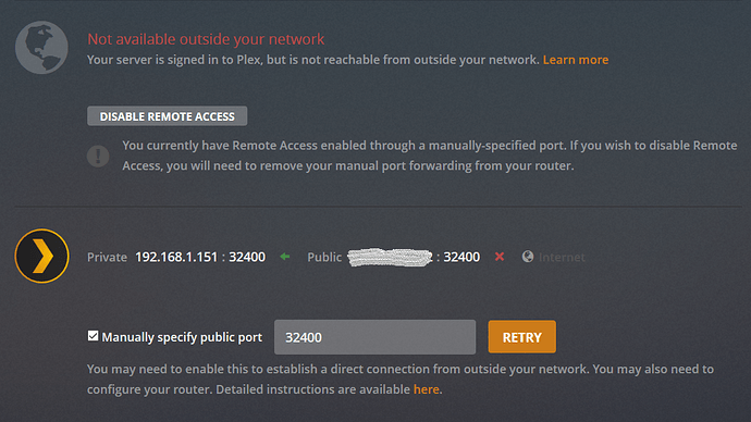

I have been trying for a few days to get this working. My router does support uPnP and it is enabled. I’ve set up my computer with a static IP, and I have manually set up port forwarding to it using port 32400 as the internal and external port. I tried disabling the PC firewall, this made no difference. I also tried setting up the DNS servers within windows adapter settings to the DNS servers that were showing in the router settings (instead of the router IP). I’ve also tried rebooting everything several times and even setting minimum security on the router firewall.

First things first, check if canyouseeme.org can see your server listening on port 32400. If it does not, post a screenshot of your Plex remote access settings as well as your port forwarding options (remember to blur your public IP).

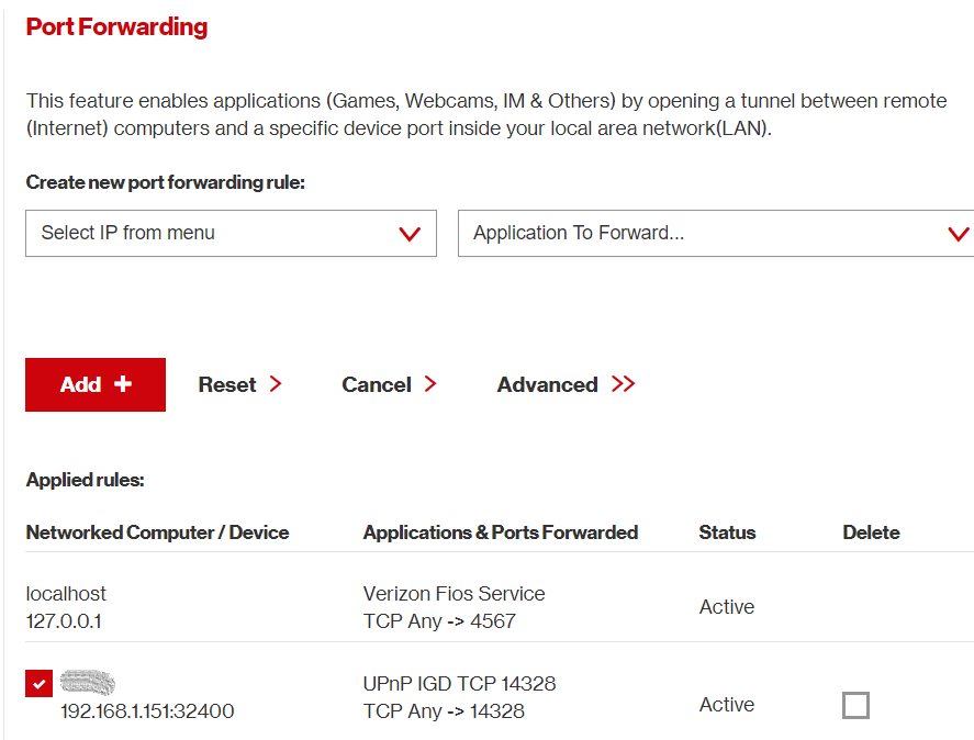

Edit: Just noticed that you’re using a FIOS router (which seem to be somewhat tricky to set up). Check out this thread which has a solution for getting it working: Remote Access - Not working

I looked at the post. It looks like he may have a different router version than I have. But it looks correct to me.
Here is the router forwarding:
Here is the server screen shot:

I took another look at the other Verizon thread and noticed the port didn’t look like it was specified. I tried advanced forwarding and was able to specify the port, that did not work either. Next I tried unchecking the manual external port. This changed the external port to 14328. When I looked at the router it looks like it picked up the change properly.
I turned off windows firewall again, but as before no luck.
I’ve been using yougetsignal.com to show whether the port was open. It is showing that 14328 is closed!?
Just tested the port again, it is now showing open through yougetsignal.com. However canyouseeme.org is still not showing the service on 14328.

Ok please try this. Turn off remote access since you have no interest in remote access. Then go to your server and click on Settings | Network and tell me what is Secure connections set to.
Secure connections is set to Preferred
Does it work if you set to Disabled?
