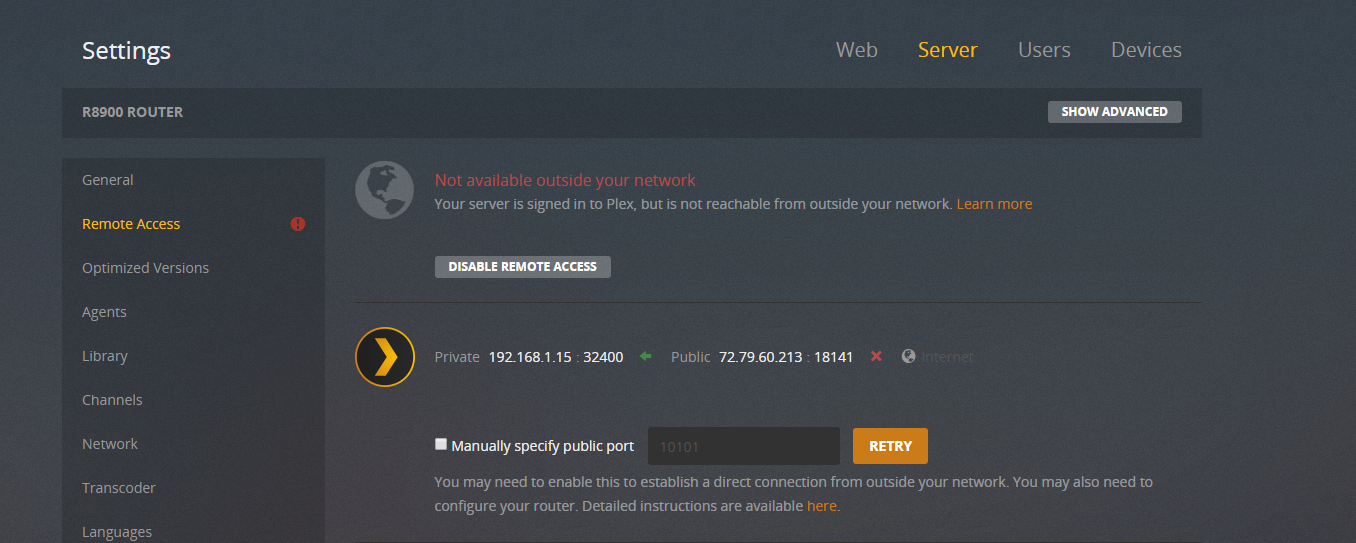

I have tried for days, but I cannot get my Plex server accessible from outside the network. Help?
I am using a Netgear R8900 router with built-in Plex server to run my media server.
Manual port forwarding and automatic UPnP both have resulted in unsuccessful connections from outside my network.
Every time I click “retry” the settings menu always turns green for a brief moment before returning to Not available outside your network. Your server is signed in to Plex, but is not reachable from outside your network.
Attached are my server logs. Please help.

From inside can you browse to http//192.168.1.15:32400
If you go to canyouseeme.org does it show same ip as in your screen shot?
If you test that port on canyouseeme does it show success?
This is all for @gutkinfam
@“riddla26@gmail.com” do you have a form post about your issue?
Yes, It is the same public IP.
The connection always times out. There is always an error.
Thaks for the help @nokdim
@gutkinfam (cc @nokdim) - I suggest you get fresh logs - the logs from jan 10th show some very strange networking behaviour - with about 8 network change indications every second

Getting up to 69 network change RTM_NEWLINK events a second does not look right. There is a network setup issue
Most of the events fall within 1-15 events a second
That a side, we have uPnP Port mapped ok
Feb 28, 2018 16:26:56.535 [0xb26ad530] DEBUG - NAT: UPnP, mapped port 18141 to 192.168.1.15:32400.
But when plex.tv was requested to test out the route into the server through WAN Port 18141 and Public WAN IP 72.79.xxx.xxx, it did not get through - confirmed by the event it sent back to show a connectivity="0" status

The test of the connectivity is through a request from back-end systems - normally from an IP address starting with 50.xx.xx.xx or 54.xx.xx.xx
Do you have any whitelisting / blacklisting of IP addresses / regions ?
@plex-linux Thanks for all of your help. Both Plex and the Netgear router have updated within the last week. There is no process that I know of that is consuming the Netgear’s resources.
@sa2000 There are no restrictions whatsoever, on the Netgear, or my main Verizon Actiontech router
try a port forward next and selecting manually specify port and entering the public port that is forwarded to 32400 for 192.168.1.15 - instead of the uPnP port that the logs showed
So how is the setup ? The R8900 is a router and you also have another router.
ISP wan connection comes to the R8900 and it has a 192.168.1.xx subnet with 192.168.1.15 is its IP address on that LAN subnet?
and you have Actionech router on another subnet with the plex client apps?
@sa2000 I have tried manually port forwarding, to no avail.
My setup is my Plex server on my Netgear R8900 router which is in AP mode. The Netgear is connected to my Actiontec router provided by my ISP.
you could get screenshots of setup (port forward/remote access server settings and logs after restart) for the port forward case and manually specify port
To eliminate the R8900 why not setup PMS on a laptop and see if the requests from 54.xx.xx.xx / 50.xx.xx.xx come in to the laptop. Then that would confirm the actionec router is not blocking anything

@sa2000 Thanks for the suggestion. I tried PMS on a PC of mine and it encounters the same problem.
we can switch the investigation to that because it would be a lot simpler - especially as you can run wireshark and see if the packets from connectivity tests are actually coming in and getting dropped before reaching Plex Media Server
Please use port forward remembering with 2 servers on the local network, you would need to have port forwards as per example here
Example
PMS1 - WAN Public Port 32410
PMS1 has local IP 192.168.1.10 which is DHCP Reserved in the Actionech router
Port Forward tcp port 32410 to local tcp port 32400 to PMS1 with local IP 192.168.1.10
PMS1 Remote Access Settings: Manually Specify Port ticked and entering 32410 in the box
PMS2 - WAN Public Port 32420
PMS2 has local IP 192.168.1.20 which is DHCP Reserved in the Actionech router
Port Forward tcp port 32420 to local tcp port 32400 to PMS2 with local IP 192.168.1.20
PMS2 Remote Access Settings: Manually Specify Port ticked and entering 32420 in the box
I tried that and still encounter problems @sa2000
As I said, we can switch the investigation to geting it to work on the windows pc as it would be easier - so we start again with getting the information and logs whilst the server setting page for remote access is on the screen as that would instigate a connectivity test when the remote access is enabled
I presume you would have gone through both router and pc reboots
Diagnostics
  • screenshot of router dhcp table showing dhcp reservation for the ip for the pc
  • screenshot of Router port forward entry For the pc plex media server
  • ipconfig /all Output from the pc
  • Screenshot of the server remote access advanced setting fir the pc showing manually specify port ticked and the port forward public port entered
  • Plex media server log file from launch up to time when the remote access fails
Please also try adding this rule to the windows firewall. This is a port rule and s additional to the 3 program rules for Plex
Port inbound rule
Remote port = any
Local port = 32400
Porotocol tcp
Remote ip = any
Programs = any
Action = allow
Also double check that the network connection is not showing as public or unknown network
After examining the logs and the screenshots it may be necessary to repeat with wireshark running on the pc - in that case the wireshark capture saved Pcap file should be zipped and sent by private message so it can be checked against the logs for that time to see if the connectivity request - is reaching the PC
Is the Actiontec also a modem?
