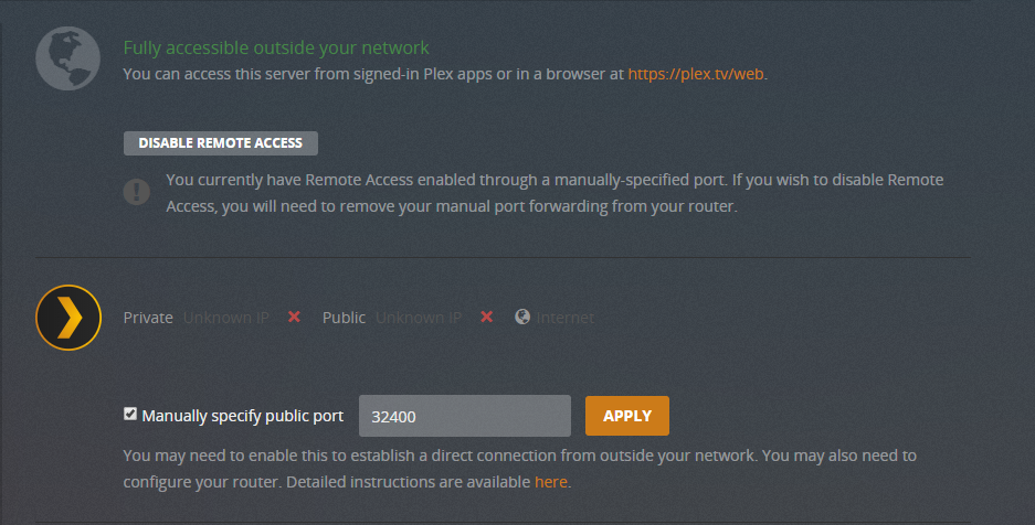

This started out of no where early this morning. I started getting notifications that my server’s remote access was down. I’ve tried everything to get it back up including restart the server software, and then the whole PC. I upgraded to the latest Plex Pass version of PMS which fixed it for about 5 minutes and then it went back down. I tried to restore my windows firewall to see if that would help, but it did not. I finally uninstalled PMS and reinstalled and this didn’t work either. I’m not sure what else to try. Every once in a while when I apply the manual port in the settings it will work for about 2 minutes but then go back down. I haven’t made any changes recently to my networking setup.

Also, often I’ll end up with this that says its accessible but its not:
