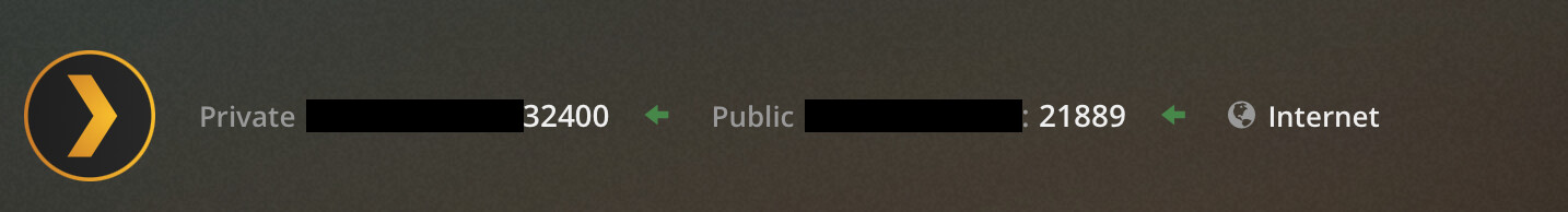

Yes! …sorry, missed that before. You want to use those numbers although not sure why your external port is 21889.
so:
  • External start: 21889
  • External end: 21889
  • Internal start: 32400
  • Internal end: 32400

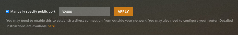

out of interest, have you manually specified your external port?
It maybe a good idea to do this so it remains constant for the firewall.
