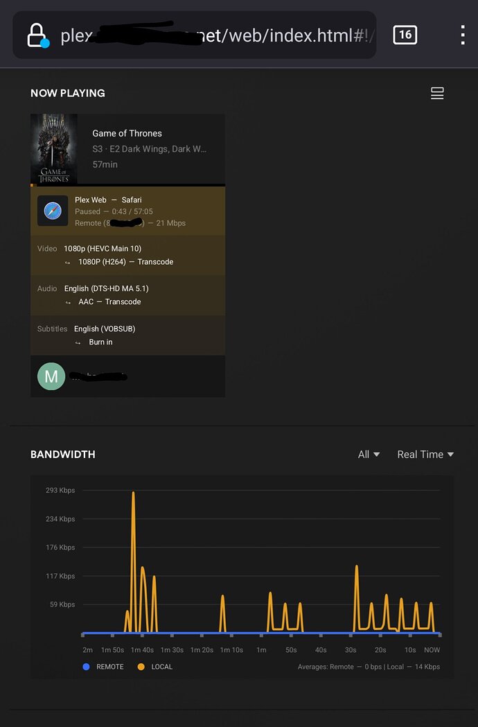

I’m experiencing the following issue which I think is a bug. First some background:
I run official docker PMS (network mode “host”) on Synology DSM 7 with remote access permitted via the DSM built-in nginx reverse proxy. This means that both PMS and and the reverse proxy are in the same Synology host. The server is reached via HTTPS at “plex.domain.tld:443” and then the reverse proxy redirects to HTTP address “localhost:32400”. Also, headers such as X-Forwarded-For, X-Real-IP and X-Forwarded-Proto are being passed to PMS by the proxy. Finally, custom server URL is correctly set in the network settings.
Now the issue: I see no remote bandwidth shown in the graphs when a remote client is playing something, although their remote IP shows up correctly. This totally feels like a bug, because Plex is identifying the source as remote (correctly) but not detecting and showing any remote bandwidth usage.

Same issue. At one point it was working but now have the same behavior as described. Additional info that OP did not clarify: he is not seeing remote bandwidth OR LOCAL bandwidth. Bandwidth is completely omitted from the graph for remote connections.
Correct @fca thanks for adding that.

However, as per my initial screenshot, the label correctly identifies the client as remote and the IP address displayed is correct (actual public IP of the remote client). It’s just the bandwidth graph that reports nothing, that’s why I’m thinking of a PMS bug.
