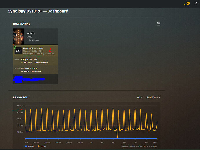

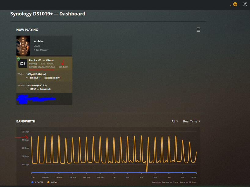

So I’m running plex ( Version 1.21.1.3876) on a DS1019+. Plex is remotely accessible over https on a private domain with ssl certs, and a reverse proxy configured on the Synology. Everything appears to be working fine, no issues with certs and remote streaming works great… however for some reason, the bandwidth monitor doesn’t show any of the remote traffic as shown below
As you can see, the reverse proxy is putting in the remote IP into the header correctly and plex is in fact picking the IP up as a remote IP. So no issues with reverse proxy.
Iniitially, I thought perhaps the plex server still might think the traffic is local because of how it’s being routed, however I noticed the stream rate was 386Kbps which isn’t reflected in the bandwidth graph. Surely enough, stopping the remote stream made no change to the bandwidth.
So from what I can tell from all this, the bandwidth being shown in the graph is just the bandwidth used from my local machine to the plex server which I’m using to actually look at the bandwidth monitor… and the remote stream is just not showing at all.
This sounds like a bug with plex. Is anyone else able to confirm?

I see where you’re coming from, but two things on that.
  1. If PMS knows a public IP is being used to connect to it, why isn’t bandwidth monitor just programmed to show it as remote bandwidth? I don’t see the reason why you would want it to show as local, regardless of the local proxy.
  2. If it’s showing as local bandwidth because of the proxy, why is there a discrepency in the bandwidth usage? In my screenshot, you can see the device is pulling 386Kbps, however the local bandwidth is only peaking at 47kbps. Further to this, there’s no change to bandwidth usage when the remote device stops streaning. This indicates that the local bandwidth being shown isn’t from the remote device at all.
This is why I’ve come to the conclusion that for some reason, PMS isn’t showing any remote bandwidth.
