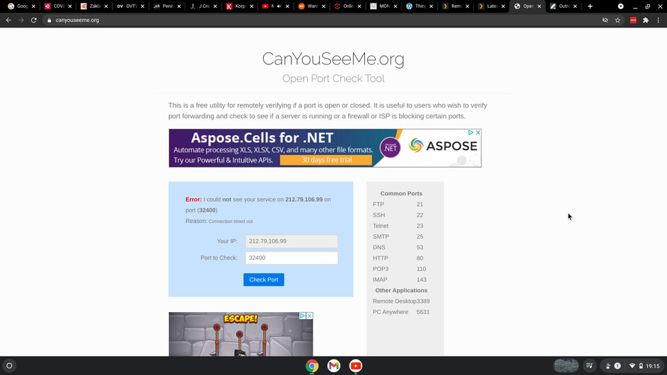

I have just checked again and the issue remains. Port checking results in service not being visible from the internet. The IP address is from a completely different range. It appears my ISP has turned security know alll the way to the right :frowning: Any suggestions how to proceed?
It’s not so much the aim for security, but the global scarcity of IPv4 addresses. Which may have played a role in the ISP’s decision to place all customers behind a carrier-grade NAT Carrier-grade NAT - Wikipedia
Some ISP’s can switch that off selectively per customer. Some do it for free if you ask nicely, some want more money to do it.
Some are trying to sell you a “static IP” additionally, which is usually more expensive (and actually not really needed for Plex).
On the images I see they are the same. What If you go to your router’s wan status page. Do you see the same IP starting with 212. or it starts with 100.?

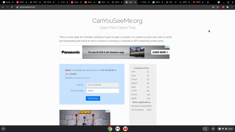

Sorry for later reply, was enojying a bit of mountain hiking. Anyway I have just checked everything again: Not available outside your network.
Specifically, Plex settings:

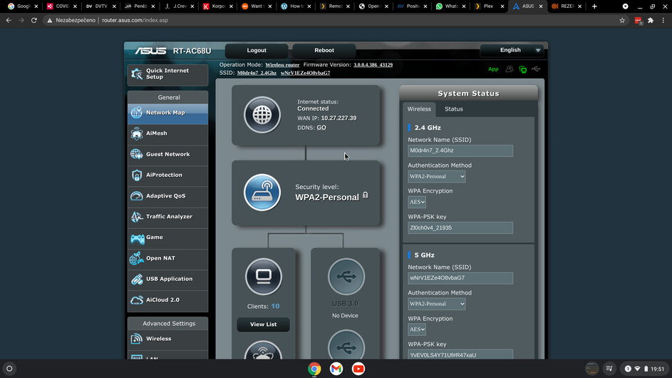

Router WAN IP is automatically assigned by ISP (MAC address was required in advance):
CanYouSeeMe screen:
So it seems @OttoKerner was right, ISP is routing my IP according to its needs. I will try to inquiry my ISP about it, thanks for hints.

You have double-nat situation. Your router is getting an IP 10.X.X.X.
Is there any device after your Asus?
So far no response from ISP, fingers crossed. There is no other network device aside from my Asus router. We have 1 Gig ethernet port in the apartment.
So in that case you’re doing the right thing, they’re the only ones that can help and probably will charge for that :frowning:
