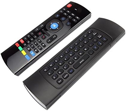

I went through a few remotes trying to find the best one. I use this wifi remote with PI2 and a custom keyboard.xml file to change a couple of the keys to make it better to use.

Benjaminwolf, does it really do voice? That sounds cool
@rswennen
It has a mic on it but Rasplex doesn’t support voice search. That feature of the remote is completely untested by me since I don’t have a minix box or other device that supports it.
