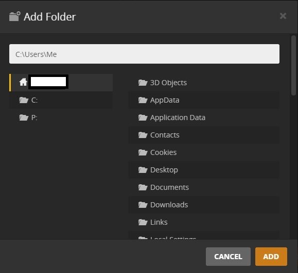

I click on Add Folder and get this:
1

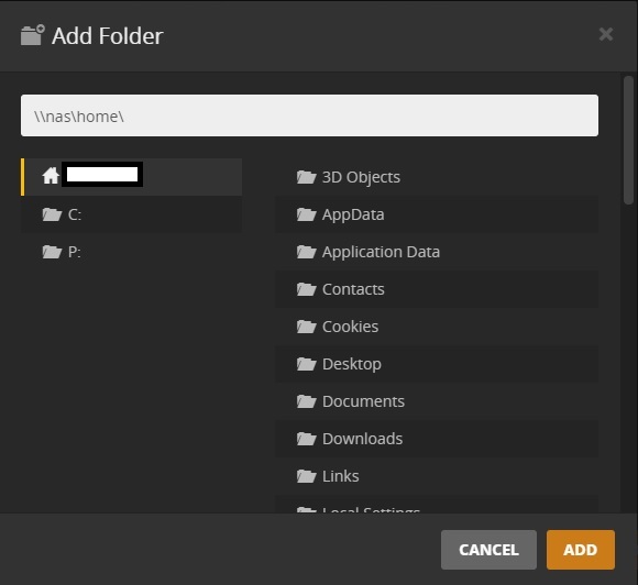

Then I start typing a UNC path and nothing changes:
2
No, I didn’t mean for you to click onto the button ‘Add Folder’.
Just go to the tab labeled ‘Add folders’. i.e. one step before
