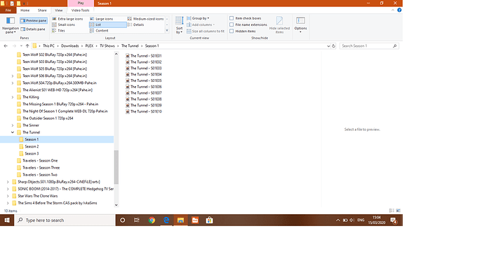

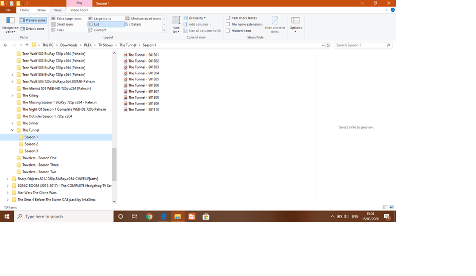

LMA is enabled. it’s at the bottom. I believe I’ve titled everything for The Tunnel correctly.
Yes, that looks good.
(set the options of your File Manager to show file extensions - that helps everyone)
Empty Trash/Clean Bundles
Put the show back in the library.
Empty trash/Clean bundles and other goodies here (hit ‘More’ at the botton of the sidebar):
Looks like the rest of his TV Shows folder structure needs help…
