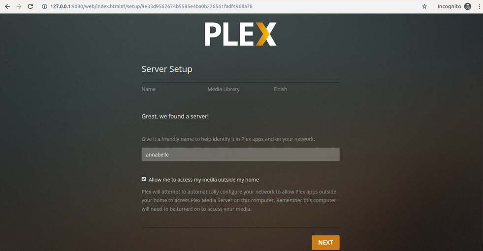

That’s exactly what i’ve been doing :slight_smile: different browser and incognito window. No luck it tells me it has found a brand new server and i should give it a new name.
What the F****

It’s the same hostname it’s always had, right?
If so, the Preferences.xml file got dinged.
A couple ways that happens: Time in the future; copied in ascii mode to a windows system; edited by a Windows editor; fat fingers :wink:
Go through the setup wizard again if the same name,
DO NOT create new sections. they still exist.
Set preferences as you wish along the way.
When you Finish and arrive at the dashboard, it’ll be fully back (unless the backup got damaged somewhere else).
No it’s a different name. This (annabelle) is just the hostname of the host server. The Plex server was named differently.
