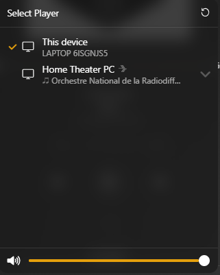

But, that is the problem. What my laptop Plexamp sees:

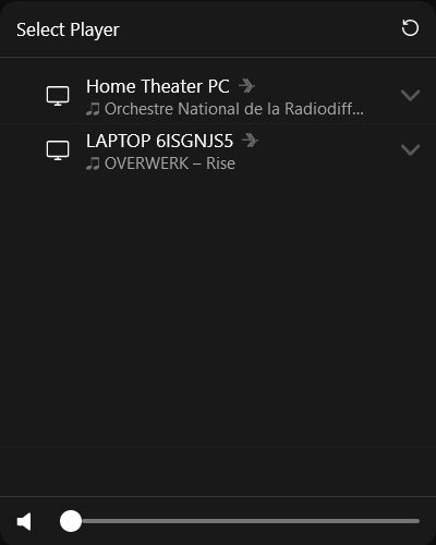

What the rPi sees:
The pi itself is not visible anywhere (should be called Living Room Pi). Also tried phone and Home Theater PC, it’s just not visible anymore.
Then we’d need to see logs from the Pi to see if it’s properly advertising.
