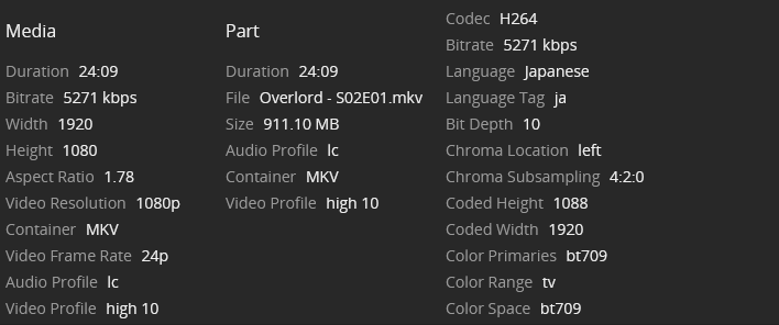

So I have been trying to watch some different anime titles on my SamsungTV and for some reason, some work, some don’t. Mainly, ones that don’t work literally will go to a black screen and sit there, not doing anything at all. Like it’s not even trying to play the files.
Now for the most part a Lot of the anime titles all are .mkv files. When looking at the file info Plex shows for ones that work vs ones that don’t, a lot of the details are all very similar but not exactly.
For example, here is Plex’s info on an episode that works without any issues on my Samsung TV:
And here is one that doesn’t work at all:

Can you show us the XML for both instead?
Absolutely. I didn’t see a way to upload .xml files so I uploaded them to Pastebin.
Working
Not Working
Thank you.
Hmmm…when lookin at the xml, I would have guessed the one you say doesn’t work was the working one :slight_smile:
But sadly failed to see anything wrong here
But when said, could you try and play the not working one again, with the PMS set to debug level only, and right after, upload the PMS Logs
LOL, that’s awesome. Yeah, I can confirm the one working is definitely it due to the name. Season 1 of Overlord worked without issues on the TV, while Season 2 won’t play any episodes at all on it at all.
