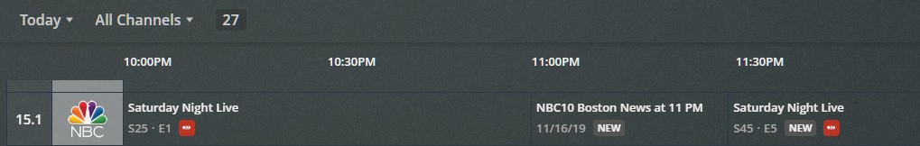

Seems like an old problem has come back again. I’m running pms 1.18.2.2029. Today is Saturday 11/16. There is a new episode of SNL airing tonight at 11:30 Eastern. My guide agrees:

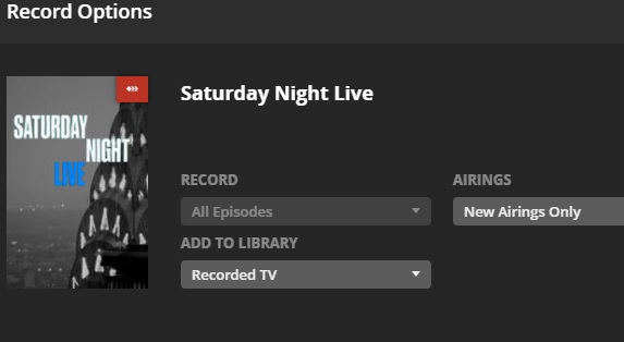

And I have a proper DVR recording set up for the series:

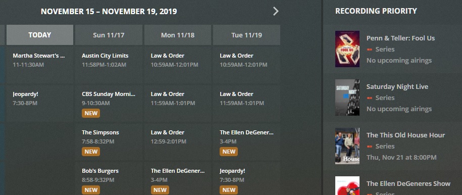

But, arrgh - my DVR schedule shows nothing will be recorded tonight:
Can I get a fix before tonight? Once again, like a broken record - if I had manual recording I could work around the issue…

Interesting. I just added SNL as a new recording (All Episodes, New Airings Only) and it shows in my DVR Schedule to be recorded:
Perhaps try toggling to New and Repeat Airings, saving, and then toggling back? Or maybe delete it and add it back?

Yeah, I’ve tried toggling new/repeat, deleting the recording and refreshing my guide. No change. The SNL repeat at 10:00 offers to be recorded, but never the 11:30 new show.
[edit] also tried “limit to air time 11:29” and single (non series) recording. The new 11:30 show never appears in the schedule.

I think it’s because the guide data is wrong. The guide shows it as episode 5 - should be 6. E5 was Kristen Stewart two weeks ago.

Yes, good catch @bartenjs. Some guides had last night’s episode as E5 when it should have been E6 of S45.
