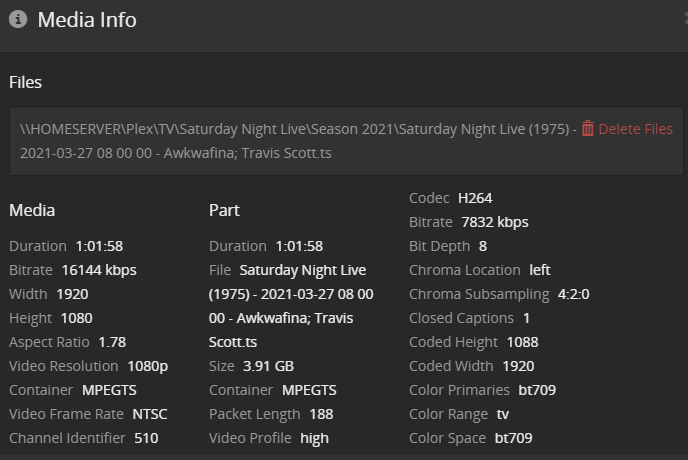

If I look at the DVR schedule, it shows both episodes each week as “NEW”, however, it only seems to record the first one (the repeat). In the library the repeat airing is given the metadata of the actual “NEW” episode, but if I do a “get info” the filename reflects the information of the repeat episode.

I still only got the first (re-run) episode recorded, but with the metadata of the second (new) episode again.
The re-run airs at 10pm
the new episode airs at 11:29pm
if I go into the advanced options for the recording, it offers me to restrict to a airing time to “ANY or 11:59pm” which doesn’t make any sense.
