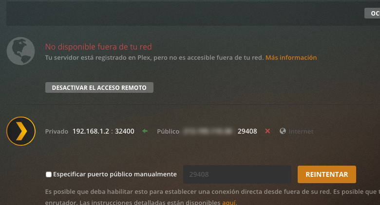

Says it has no external connection, but if it works
Server Version#: Versión 1.19.2.2673 , Ubuntu
Player Version#: android phone or sony TV or LG
It says “Your server is registered with Plex, but it is not accessible outside your network.”
Automatic port, I have been years without problems, after the last update, although not if it is the reason, because now it gives this so rare error.
it says it has no connection but then it works.

I have checked the firewall, the router port, I have called the internet company to see if it had a unique public ip. and it only turns green and red varying

It’s complaining because, apparently - but I can’t see with just this one log file - it’s requested a port map (UPNP) but the UPNP hasn’t replied.
It therefore fails the reachability test (return = 0) and this is what you see.

For something that I do not know, the router of the company was playing, I have reset and configured my ip again by dmz, now it seems fine.

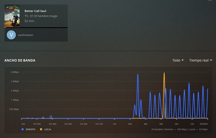

after an hour it gives me the error with the router again, the web says open, the plex says error, but it works from the outside, there is a reproduction from my phone with 4g android
