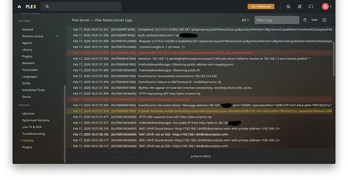

@sa2000 Agree. I am concerned that Comcast is losing port forward and DHCP reservations. Xfinity Xfi advanced security was already off for me. Had to implement a port trigger instead of a port forward since Comcast has somehow bungled up port forwards. Still can disable and enable remote access in Plex. Ping successfully from CanYouSeeMe for a few clicks, then this error shows in the log and remote access is gone. So sorry not sending all. Too much identifiable info in there. Not sure everyone with this problem is on Comcast… May look to replace Comcast gateway.
